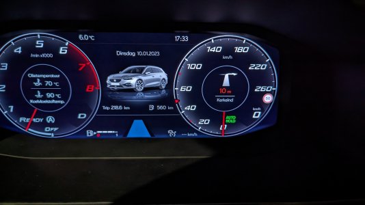

  • Full link funktioniert nicht Beitrag #123
I've made a video.
At first my iPhone is connected and CarPlay is started but no destination is set in Apple Maps.
As soon as I've set a destination the information is shown in the cluster. Both on the right as well as in the middle.
I then switch the middle information a popup is shown which is also shown when the next action is due.
After that I stop the navigation on Apple Maps.
  • Full link funktioniert nicht Beitrag #124
Another video while driving showing a popup with a progress bar for the next navigation action.
  • Full link funktioniert nicht Beitrag #125
Thank you for the videos. I thought the arrows will be shown in tube on the right. But the pop ups are also fine.

Ja, lief erst nicht wireless. Dann im Steuergerät 5f Multimedia die Anschlüsse AA/Carplay USB only auf on gestellt. Tip hier aus dem Forum, weiß aber nicht mehr wo es genau stand.
Hier mal Screenshot aus dem spanischen Cupra Forum, wo es einer mit OBD gemacht hat. Screenshot_20230119_164218_com.android.chrome.jpg
